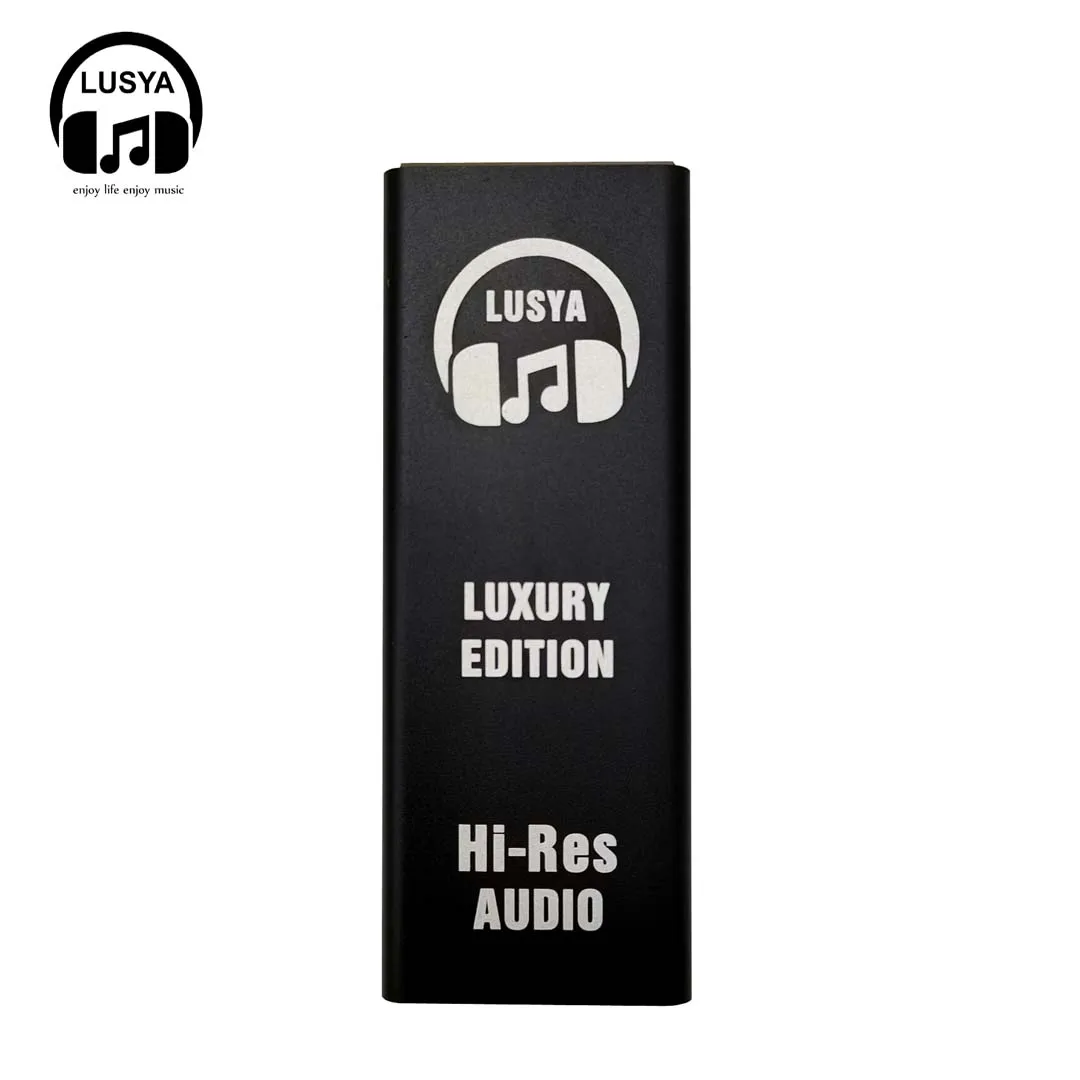

https://www.aliexpress.com/item/1005003176732524.html
700mw might be legit actually…
didnt have any problems with my 300ohm DIY buds
but OI seems pretty high
(FYI: I am using it with my motherboard 3.5mm, so the OI could be influenced by that as well…)

Some more info regarding this:
LUSYA EF04 MUSE02:
Sundara: can drive it but not as good as the A3 (looser bass, less treble air, res seems a bit worse could be due to the warmer tonality)
CRA: hiss, sensitive enough to be used at a volume level where there is channel imbalance
LZ A7: extremely little hiss
Tanchjim Oxygen: extremely little hiss
Sony XBA-N3: extremely little hiss
Blon 03: extremely little hiss
Sony EX800ST: Slight hiss
(extremely little hiss = only noticed when I disconnect them from the amp, and less noise than the fans in my pc besides me lol)
Overall, the tonality of it seems to be more bass quantity and looser, more elevated vocals and less air, separation is worse than the A3. I wouldnt use it for sensitive iems since the L/R channel matching isnt that good at the low volumes they are at (still better than the JDS Atom at this), although this isnt an issue if you lower the volume on windows. Hiss isnt a problem either, unless they are sensitive.
This is more of an earbud and headphone amp than for iems though and is probably my default rec for buds anywhere near this price range.
(Tested on my motherboard 3.5mm, so it is probably better on a proper dac.)

Do you have some pictures? Specs wise it seems really amazing for the price, but I am afraid that the hardware quality of anything is really poor. Also, this micro USB in 2022… I am wondering how it measures in reality as well in comparison to power DAC let’s say
