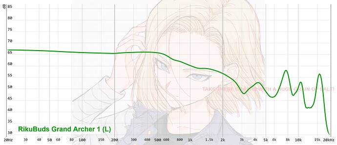

Someone graphed my GAS2. Guess volume matching with my own ears works just fine (along with resistance matching). ![]()
Any chance you can graph all your buds like this? The “normal” IEM way? The one you have with the straight line up to 500 Hz and then it just goes downhill are confusing (for me at least).
That way does not work at all, and is extremely memey. (extreme inconsistency.)
Example.
(the 3 graphs are the same bud.)
the ones graphed in my squig is done via a sealed method. (using earbud → iem adapter.)
