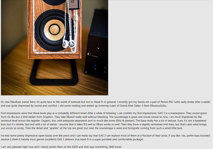

https://www.head-fi.org/threads/rikubuds-hangout.965014/page-10#post-18097475
