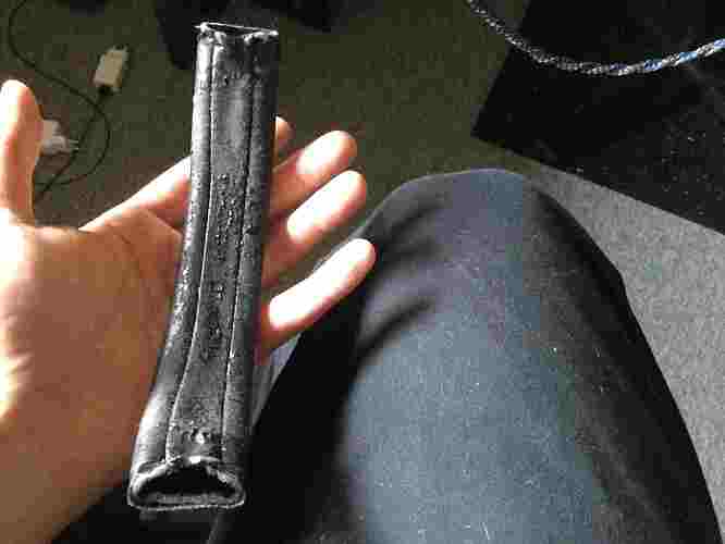

I have final pictures of the restoration here.
That was the old state when I bought it.
What I changed was the headband, which my wife sewed for me.
I chose a textile suede in black.
I have to say that it is very pleasant, and a little padding again.
The stubborn KAbel replaces that of Via blue epc 2.
And new pads, of course, from Accesorry House with the Dekoni Attunion Rings.
Only later did I decide on the Lawton mod and the E-Mu Cups.
