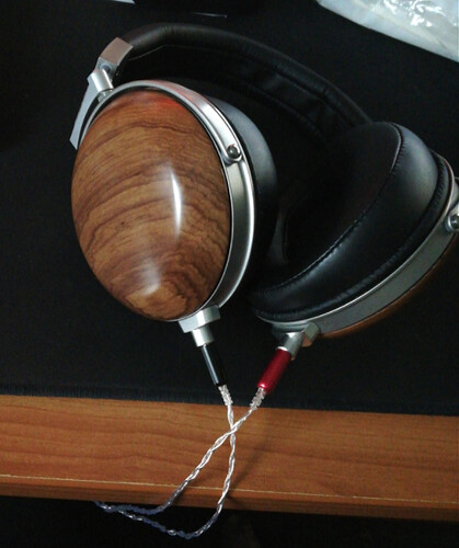

Wild Ziricote Type 5 Lawton Cup⊠VERY different
Much less bass overall and whatâs there is super tight and extends low. More forward mid range and top end - much more vocal oriented. No sharpness in treble but definitely brighter but not too bright.
So far favourites are Wild Chechen (Type 4) followed by Black Limba (Type 1). Black Limba was much much warmer and fuller sounding. More listening to be done!

TH610 swapped over to Flame Marble Walnut Lawton CupsâŠ
Ahhh thats better - a bit of warmth has come back as well as punch and depth to the bass. Very nice.
