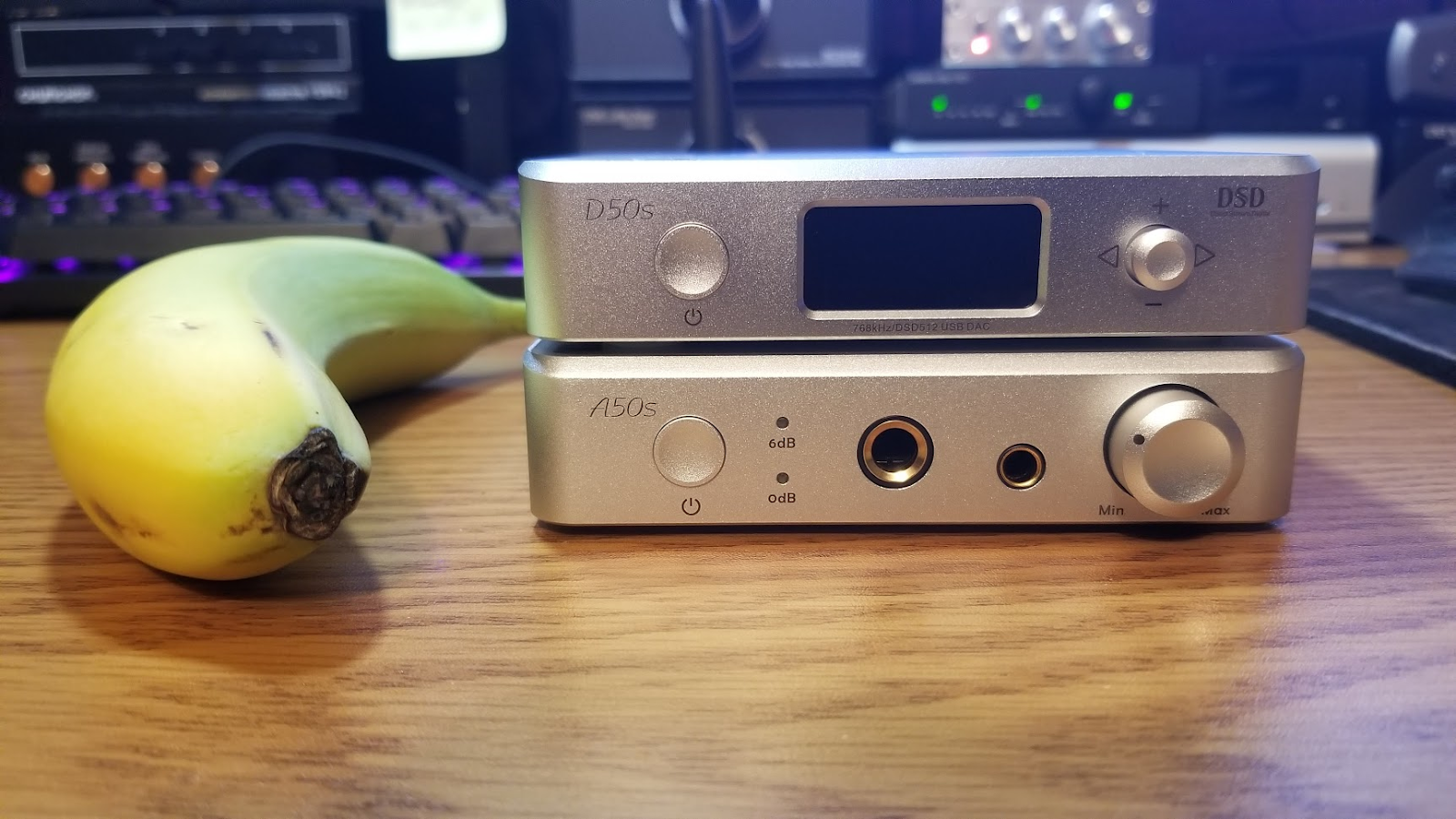

(thatās the matching D50s DAC on the left and top)
The outer chassis is all metal and quite rugged. You could probably drive over this thing with your car (disclaimer: donāt drive over an A50s or any amp or dac!) and it would be fine. You can see I got the silver finish version and it looks quite handsome, IMO. The back panel boasts the DC power input, and 2 pairs of RCA stereo analog connections for signal input and preamp output. Let me comment on further on the power supply, the input connections, and the preamp in the next paragraphs, because I think there are important points for each.

Back to the overall build qualityā¦the front of the A50s sports the potentiometer knob, a 4.4mm pentacon balanced headphone output, and a 6.3mm (1/4 inch) unbalanced headphone output. There is also a button for power and gain level toggle. To turn the unit on and off, push and hold this button for about 2 seconds. To toggle between low gain (0 dB) and high gain (+6 dB), quick press this button. There are 2 white LEDs to indicate which gain level is selected. When the unit is powered on, one of these two LEDs will be lit. One more comment on the potentiometer, there is a low-level channel imbalance between about 6:30 and 8:00. This is another common problem for amplifiers with cheap pots, but for this price I think Topping could have used a higher quality pot.
Letās talk about feet! There are 4 square rubber feet on the bottom of the A50s and they are some kind of sticky! The A50s isnāt heavy, but itās also not light for its size. However, itās light enough and small enough that a signal wire that hangs off a desk could slide it around but for these feet. Wow these things have some grip! I set up the A50s, its matching DAC (D50s), and a Schiit stack on a TV tray I commandeered to use as an end table next to the couch in my basement:
When I sat down the A50s was just outside of comfortable armās length to adjust the volume. So, I leaned over and grabbed the little Topping stack to slide it across the tabletop toward me. Nope! The whole darn table tipped over because those little feet are so darn sticky! These sticky feet were a smart addition, IMO. Because even bigger heavier amps like the Asgard 3 will slide around on a desktop when you try to push a headphone plug into it. I did not have that issue with the A50s.
