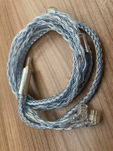

Just a little balanced cable for my BLON BL-03’s and KZ’s.
