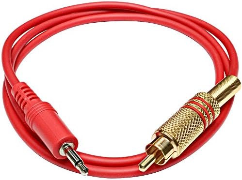

Will this cable work to get the coaxial digital output of my D10 into the XD-05?

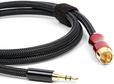

It might work, but to be safe I would go with something like this
Reason being is I have tested the xduoo with 3.5mm trs and not 3.5mm ts for coax, not sure if the mono would work properly
The picture showing the pin out looks like the ring is unused. For $6 I’ll be a lab rat and see if mono works. Thanks for the alternative if it doesn’t.
Yeah it should work, but who knows lol. Fiio is stupid and uses some trrs 3.5mm coax cables so I typically play it safe
This cable DOES work with the xDuoo xd-05.
