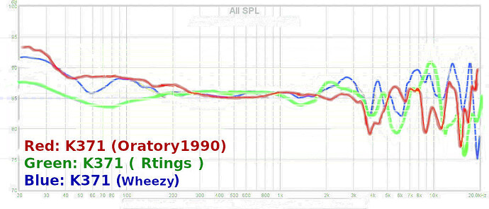

I’ve just done that for fun… lol.
That graph lookin scuffed
That’s my cheap ass free-photoshop-clone skillz. :stuck_out_tongue:
Good stuff. Compensation(s) used and how did you apply them?
Uh, Wheezy had HEQ, and Rtings got their own “mix” of things… It just shows that everyone measures headphones differently.
Rtings don’t have “raw” data so it would be harder to compare. Hmmm.
Lies and deceit ! Rtings do have raw data:
Left
Right
I mean yes, but, too raw :stuck_out_tongue: Haha (sorry I mean – the other two are harman compensated).
HEQ = “Target Response” ? If it’s the case, hmm, messing with a photo editor (to make the yellow, dotted target response horizontal, flat) gives me something really similar to Wheezy’s (harman compensated) measurements.
Edit: Rtings, compensated, without their own “mix” of things (i.e.: The graph they show to everyone), are 5dB down from 0hz compared to the others, a slope ending at 200hz. From 200hz to 10khz, yeah, really similar to Wheezy. And a hole at 12khz.
Anyway. I’m half asleep and messed a bit too much with this.
TL,DR: Rtings don’t seem to do much to the harman curve except lowering the bass, adding 5dB at 10khz, and removing like 5dB at 12hz for their “official” graphs. And with that, the green line (there) would be even more similar to the two other measurements from two other, different sources.

K371, according to multiple measurements from multiple sources = Sub-bass boost +5dB, beautifully neutral mids for monitoring, and okay treble and “air”, so, these closed-back won’t sound closed (or “claustrophobic”.
