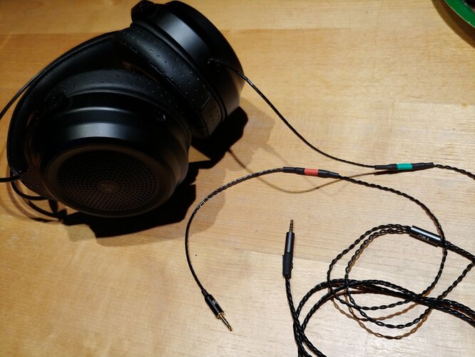

I received a rely back from James at Hart Cables:
Hey Vinie, thanks for contacting us. Sorry of the delay getting back to you. Been swamped here. Iâve been working on doing a cable for those cans, but I keep seeing inconsistent stuff about what the stock cable actually is. I still havenât found a definitive pinout for their stock cable either. If you can track that down or buzz it out yourself with a meter I can definitely make a cable for them. If you have pictures of your cable you could share with us thatâd be amazing as well.
As for your order, please bear with us on the lead time. Weâre working as fast as we can to try and meet the increase in demand lately.
Thanks again
- James
Does anyone have this information that I can pass on to him?
Left uses Tip/Sleeve.
Right uses Ring/Sleeve.

I have the Vokyl Erupts with the original wiring since some weeks and I am actually very happy with the sound and very annoyed by the cables. I only started to really use them (not for gaming) with replacement cables. Alternative cables are the ones sold for the Sol Republic Master Tracks HD / HD2 / V8 / V10 / 12 / X3⊠headphones which you can easily find on amazon for about 10 bucks. The Sol Republic cables have 2.5mm TRS stereo tips and small plugs which fit perfectly. The T and the R rings of the connectors are BOTH connected to hot/+ on both sides and the S ring is ground/- (I actually donât know why they have chosen that pin-layout since I donât own Sol Republic headphones). So you can not swap left and right like for the original cables but you get signal on both cups since one side is using the T and the other one the R ring. There are several variants and I tested two of them. Unfortunately those have Mics/remotes in the cables but there are variants without any inline-remote. Here in Germany the ones I successfully tested are:
cable and cable2. I am still waiting for the delivery of this one cable3 which does not have this IEM-style inline remote like the other two.
Thanks for the tip, ordered: nomic https://www.amazon.com/dp/B07PPRDVK6/ and mic https://www.amazon.com/dp/B07PMNWR1W/ got them in today and they both work.
Welcome. Here another tip for those who are not afraid of a bit DIY: I am not very good in soldering tiny connectors but manage to solder wires quite decently. Thus I cut the plugs plus some cm of cable of one of my spare SolRepublic cables and connected them to a balanced 4pol 2.5mm IEM cable of which I removed the (defective) MMCX connectors. Now I can drive the Vokyls balanced. It is for sure not an audiophile grade cable (very thin wires) but at least I can use the Vokyl with those of my DAC/AMP devices which ONLY have balanced outputs (i.e. iBasso DC01, PowerDACv2 and E1DA 9038s).

These will only work if the Vokylâs are modded to be balanced.
